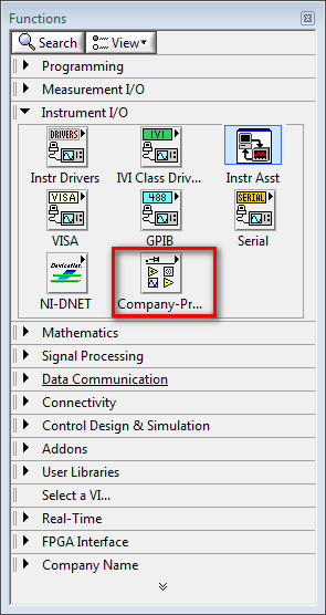

Palettes
For VI-based APIs, palettes must be created in order for users to effectively utilize the functions of the API.
Please refer to 'Creating a  LabVIEW Palette' for an example on creating LabVIEW  Palettes.
Use the palette editor (Tools > Advanced > Edit Palette Set) to interactively create .mnu files to represent the palette organization. For more information on how to create and edit palettes, click the Help button in the Edit Controls and Functions Palette Set dialog box to view the Help document.
Do not edit or replace any of the existing .mnu palette files when integrating into the palette set.
The recommended place to store palette menu (.mnu) files is in LabVIEW\menus\Categories (instr.lib or vi.lib\addons\ is also acceptable), which loads subfolders and .mnu files in respective categories in the LabVIEW palette set. We recommend the following approach:
  • Integrate your palette into one of the existing categories by either creating a folder for 'CompanyPrefix Product name' in one of the existing category folders, or by adding your .mnu file to one of the existing category folders (LabVIEW\menus\Categories). Be sure to use the 'CompanyPrefix Product Name' naming convention for the file or folder name, or name the folder 'Company Name' with subpalettes containing your separate products. Do not edit or replace any existing .mnu files.
When integrating into the existing LabVIEW palette categories, the following table lists the palette category, the corresponding folder on disk, and whether or not it is locked from adding your palette to it:
Palette Folder Name (in \menus\Categories unless a path is provided)
Locked?
Programming Programming Open
Measurement I/O Measurement Open
Instrument I/O Instrument Open
Instrument I/O > Instr Drivers LabVIEW\instr.lib\
Vision and Motion VisionMotion Open
Mathematics Mathematics Open
Signal Processing Signal Processing Open
Data Communication Data Communication Open
Connectivity Computer Open
Control Design & Simulation Design & Simulation Open
SignalExpress SignalExpress Locked
Express Express Open
Addons LabVIEW\vi.lib\addons\ Open

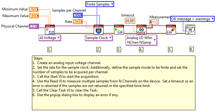

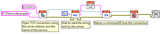

Example VIs
The examples shipped with an add-on should be deployed to the LabVIEW\Examples in a folder following the 'Company Name\Product Name' naming convention as described several times in this document.
When writing example VIs, each example needs a VI Description (File > VI Properties > Documentation > VI Description) so users can learn more about the example’s functionality.
This VI description not only appears in the Context Help window for the example VI, but it will also appear in the NI Example Finder for browsing examples. Please refer to the next sub-section of this document for information on how to incorporate example VIs into the NI Example Finder.
The following are also recommended guidelines for example VIs:
  • Include a free label on the front panel of an example VI providing instructions to the user for how to operate the VI.
  • Make use of one or more free labels on the block diagram to illustrate the use of the API in the context of the example VI.
  • Set the default values of all front panel controls such that the example VI runs properly with no additional configuration required by the user.
