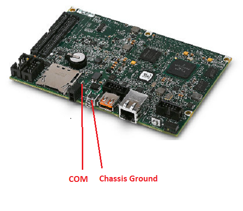

With the device you still have that is experiencing this odd behavior, could you please tell me the voltage between chassis ground and COM while the device is powered on? Please have everything else disconnected so it is just the sbRIO being powered. I have attached a picture you can use as a reference:
If COM and Chassis Ground are tied together, externally, and the polarity of the power connector is reversed, damage could occur to the protection diodes on USB and Ethernet. Is there a possibility that this happened with your device?
Do you have other devices that are functional and do not experience this behavior?

I have only two of these devices. One (Evaluation Kit) is sent to NI with RMA. The other one is running in the lab.
Pretty sure that polarity of the power plug was always right. The Evaluation board had no extra grounding connection to the power GND as it was delivered together with a mated power supply ready to start.
The one I still have here in the lab is connected to the instrument with many lines. It is not good to stop working at the moment and disconnect everything.
The measured DC voltage between the power GND and the chassis GND is about 7 mV during full operation.
Uwe

7mV is expected. Is the device you currently have in the lab working properly at the moment? Can you see if the FPGA is extremely hot? I do not recommend touching it but if you can measure that temperature at it is above 85-100C, I would say there is an internal short in the FPGA due to DIO overvoltage or ESD. I do not think this is the case, however.
