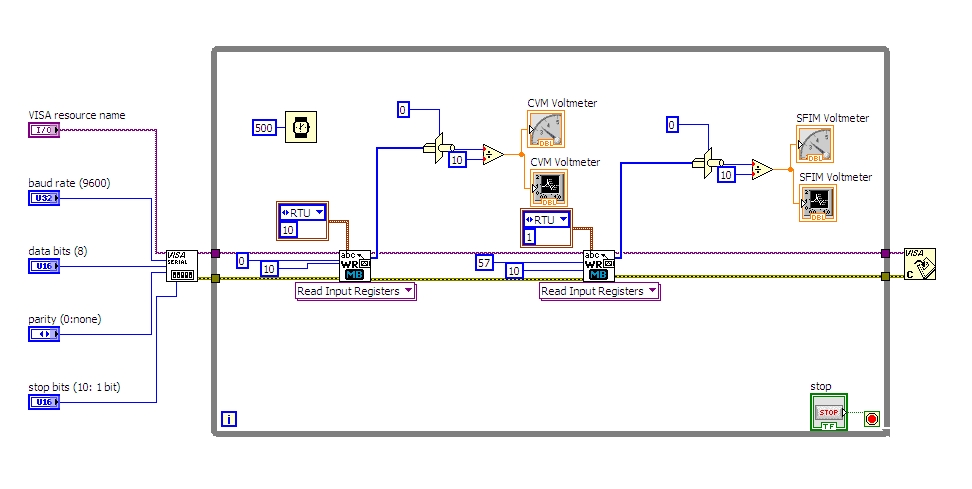

i wanna ask how to multiple request and response on MODBUS RTU using VISA ? i tried to monitoring 2 device digital metering, i made a Labview program to communicate that device alternately using Stacked Sequence Structure, but it only can communicate with 1 device, and the response i think there are some error, the number of byte doesnt match what i request ( 0A04 0000 0002 70B0 )
this is my screenshot
and then i tried this and this not working too
any suggestion ? or maybe use other way to multiple request and response use NI VISA ?
Thanks~

Hi rhiesnand,
To check if you are getting errors, you can wire error indicators to the error wires. This will allow you to see if there are any errors being generated in the VISA Read/Write VIs.
Is the CVM device working as you expect? Are the CVM read buffer, substring, byte count and voltmeter values correct?
It may be that there the full frame is not available yet when you are doing the VISA Read because you are using the Bytes at Port property rather than specifying a fixed number of bytes to read. If you use constants for the bytes to read, do the read buffers show what you expect?

Hi Catherine,
i think no, you can see that i request  0A04 0000 0002 70B0 but the answer is incorrect, the number of byte doesnt match. you can see this video :

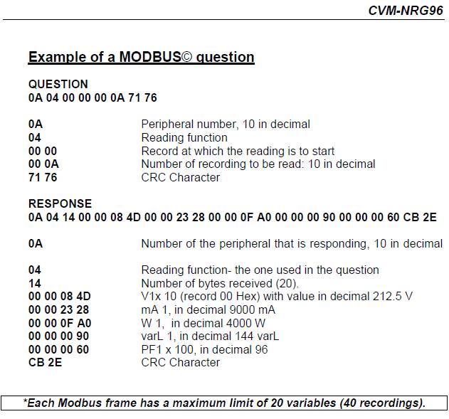

according on that manual of CVM if i request 10 register from 00 (starting address) that should be response Volt, Ampere, Watt, VarL,PF.
any suggestion ?

Hi rhiesnand,
Can you clarify the behavior you were seeing when using the NI Modbus Library? Was it successfully reading the first register specified, but not all 10? The output of the Read Input Registers VI is an array of values, so you may need to extract the elements or index through the array to access all of the register values.
