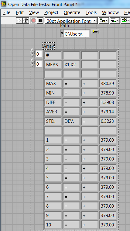

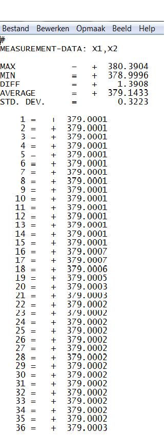

The instrument is sending me data. You can see it in the picture left. And my purpose is  that the data automatically go to an array like in the picture in the right.

In the VI you can see that i first need to save the receiving data into text file and than I can get into an array.
But I want that the receiving data goes automatically into the array.

You just need to pres export on the ND 287 and it will send it all at once.
i used Measurement and automation explorer.

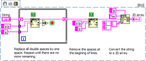

This conversion from ND 287 string to a 2D array of strings is quite easy :
