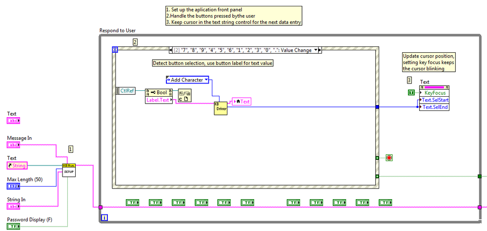

This example provides tools to implement a pop-up alpha-numeric keyboard or numeric keyboard in a LabVIEW VI or application.  This is extremely useful in touch screen applications.
Description:
The main elements of this library are the pop-up alpha-numeric keyboard VI (HMI Pop Up Alpha KB.vi), the pop-up numeric keyboard VI (HMI Pop Up Num KP.vi), and an example VI (Sample Usage.vi).  The library also includes custom controls and a keyboard driver.
The keyboard VIs can be used as subVIs, as shown in the example, named Sample Usage.vi.  In this example, when a user clicks on a control on the front panel, either the alpha numeric or numeric keyboard pops up.  This is done using an event structure as shown in the code below.
After the keyboard pops up, the user can type, and then press accept.  This will close the pop-up and the words that were typed will be entered in the control. The keyboard VIs include a setup, an event structure, and a finish.  The event structure executes each time a button is pressed.
In the event structure, information is passed to the keyboard driver each time there is an event.  The keyboard driver performs an operation and then returns the string and the edit position.  The keyboard driver is works as a functional global variable.  Depending on the command, it will initialize, add a character, replace a character, delete a character, move the cursor to the left or the right, update the edit position, or nothing.  The edit position, string, and maximum character length from the previous iteration of the driver are stored in shift registers.

  2. If you would like the keyboard to pop up in response to an event such as clicking a text control, place the subVI in an event structure and program it for the appropriate event.  This can be seen in the example VI provided (Sample Usage.vi).
 Sample Usage Example VI Block Diagram
Alpha-Numeric Keyboard Front Panel
Alpha-Numeric Keyboard Block Diagram
 Numeric Keyboard Block diagram

Your open square bracket button does not work, this is only because you forgot to add it to the event structrue. Simple mistake especially with so many buttons on the screen. Anyone who needs to add this simply select the correct case on the event structure (the one that has all the numbers, letters and symbols) right click and select edit events handled by this case then add event and find the [{ control and click OK, you are all set to go then

Works Very well, Only issue I found is with the current download the 3 button on the keyboard is not set up in the event structure.
Just required a minor update before full use.
