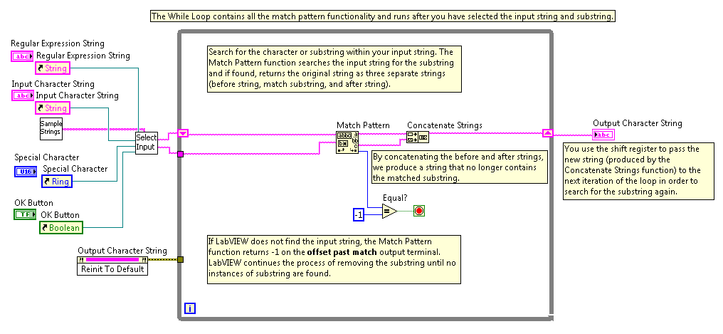

Coding that exemplifies how to remove all occurrences of a certain substrings from a larger string.
Description
This code removes all instances of a selected character by continuously searching and removing each individual instance until no further instances of the substring remain. In other words, the output character string will be a copy of the original string with all instances of the substring removed.
Requirements
LabVIEW 2012 (or compatible)
1. Run the VI.
2. From the pull-down menu on the front panel, choose which substring you want to match.
3. Click the OK button.
