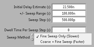

Use this VI as reference on how to set up a fast delay sweep with an RFmx AMPM measurement at each configured delay. There are two methods proposed:
- Fine Sweep Only: Sweep from (Initial Delay Estimate - Sweep Range) to (Initial Delay Estimate + Sweep Range) in (Sweep Step) steps
- Coarse + Fine Sweep: Perform a coarse sweep to determine a first estimate of the optimal delay. Then perform a smaller sweep with the defined Sweep Step size around the first estimate to find the optimal delay. This method requires fewer steps and is usually faster.

- Configure the sweep parameters using the Delay Sweep tab. Make sure to select an appropriate initial delay estimate. You can also configure the AMPM measurement.

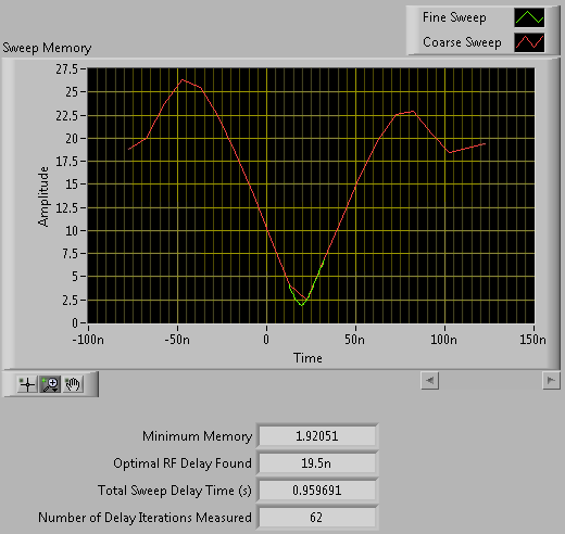

- In Fine Sweep Mode, you should see the AMPM sweep results under the Sweep Information tab:
- In Coarse + Fine Sweep Mode, you should see the AMPM sweep results under the Sweep Information tab:
