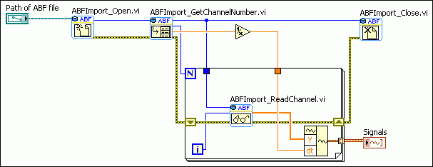

The following figure shows the block diagram of the Read ABF File VI:

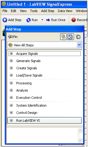

- Click the Add Step button and choose Run LabVIEW VI»Run LabVIEW 8.5 VI in the Add Step dialog box.

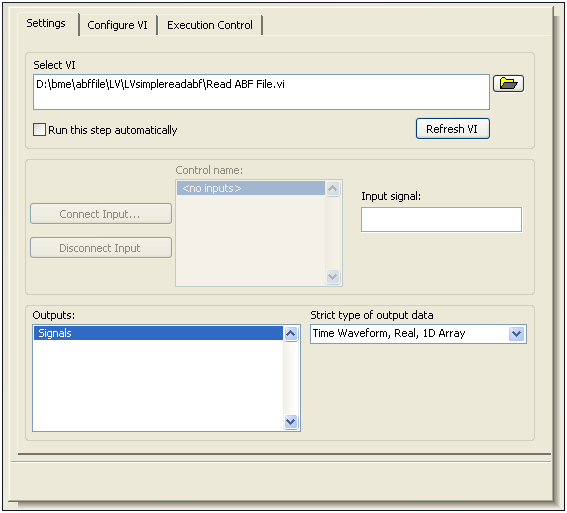

- In the Settings page of the configuration panel that appears, click the Browse button and navigate to the Read ABF File VI that you get from the attached ZIP file.

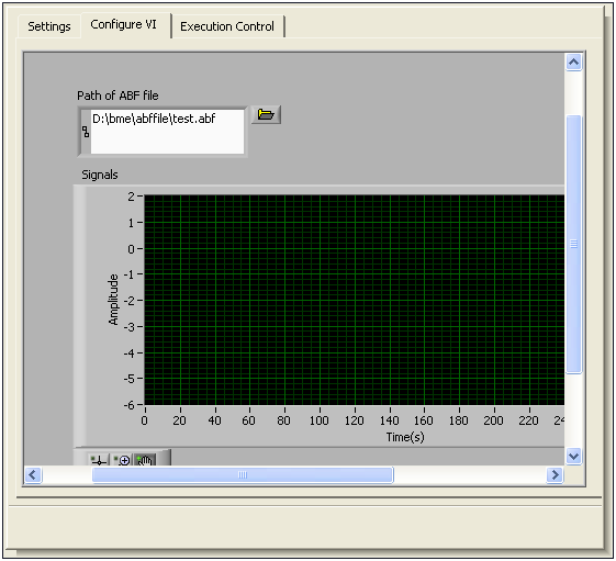

- In the Configure VI page, click the Browse button and navigate to the ABF file from which you want to read signals.

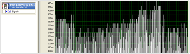

- Run the VI to extract the signals. You can drag the signals to the Data View graph.
Figure 5. Extracted Signals
