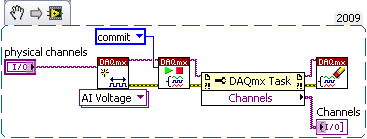

This VI shows how to use this handy converter to create a dummy task and extract the channel list in array format.
Description
You may find a need to extract the individual channels from a task that was made by using some sort of short-hand syntax. (What is the Syntax for Physical Channel Strings in DAQmx?

1. Open VI
2.Select physical channel
3.Run the VI.
