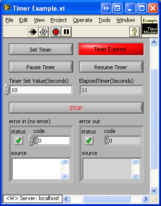

A generic timer module (subVI) that tracks target time and sets up a boolean "Expired" if the elapsed time is greater than target time. The timer also allows pause and resume features.
Description
This VI uses a shift registers to hold timer state, target time, elapsed time and  time stamp of last action. These registers retain values as long as LabVIEW is running in background.To use this VI effectively, set the command enumerator option "Set Timer" and place the target time in "Timer Set Value(Seconds)". Commands Check timer can then be executed as many times as required to check if the elapsed time has passed target time value. The output boolean "Expired" is set true if the timer has expired. The timer can be paused anytime before the timer expires and the VI will pause the timer and wait for the resume timer. Once resumed, the timer will start from where it was paused until it reaches the expired state.

  1. Run the VI
  2. Set, Pause and Resume the timer in seconds by clicking on buttons on Front Panel.
The Context Help for the Timer Utility
VI Snippet of Timer module
The Front Panel of the Timer Test VI lets you Set, Pause and Resume the timer in seconds.
