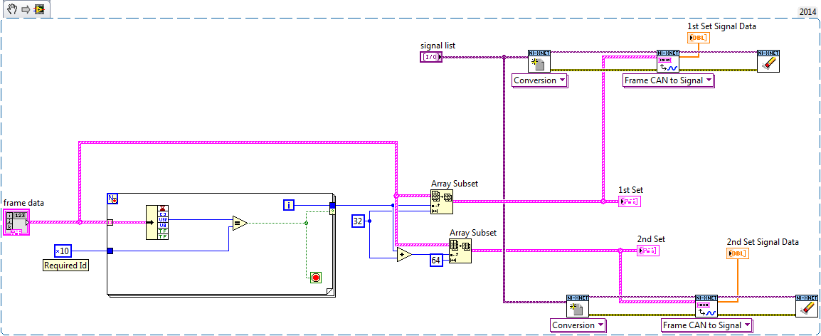

The CAN frames I recieve per cycle are with the following identifiers:
[1 frame] 513 (Radar status- range, elevation, target type)
[1 frame]1536 (Target status - No of targets near field from byte 1 and No of targets far field from byte 2)
Followed by 96 message pairs of which 1-32 pairs are for near field and 33-96 are for far field.
1793 (Target Info 1)
1794 (Target Info 2)
For the filter, I need to to identify the 1536 frame first and read byte 1 and byte 2 which gives me information about the number near and far targets respectively.
Then I need to pick (equal to byte1) number of message pairs from the first 32 pairs and retrieve sigals from that; and then pick (equal to byte2) number of message pairs from then next 64 message pairs and retrive signals.

Dear all,
I have tried to use filters to take out the first frame [1536] and then isloate the first number using Index array and string to number functions. But I do not know how to split up the 96CAN frames  pairsinto 32 and 64 and then plot the signals.
I need to make a new version which plots only what is useful data. Suppose there are 10 Near field targets located, it has to be taken from the first 10 message pairs and the rest discarded as it is not useful.
I can get the payload message but not able to split it further.

Hello Red,
Check this Snippet. you need to use array function to split your Frame Data.

Hey munna,
Thank you for the snippet. It follows the logic I had in mind.
I incorporated it into the main code but it seems to hang and the whole VI closes.
Cannot figure out what is wrong with it.

Hello Red,
I saw your code. you need do some modifications.
1. your using STOP vi in ForLoop. when it's true then it will stop your main VI completely. It's like abort button. Instead of that right click on forloop and select Stop terminal.
2. your passing two index arrays to Forloop (CAN Frames & Search ID Array). if your giving like this, it will always executes based on least array index. So suppose you have 100 frames then it will runs up to 7 times (because your array have 7 elements)
3. why are taking index from foorloop and again using other loop with Shift registers?  you can take last value directly from your 1st FoorLoop. Right click on the Tunnel and Select Last element.
4. In your VI, your always clearing your XNET reference. Suppose CAN Frame is not present in next iteration then it wont take previous value. it will give you default value (max- 0)

Dear Munna,
I have checked all points except the second point were I am using for loops for CAN frames.
The code is yet hanging and not giving a chance to run/debug.
Please look into the code one more time.

Hello Red,
Please check the attached code.
let me know if need any other information.
Munna

A lot of connections had been disconnected to the property nodes. I could not run before fixing them.
I believe that the due to invoking two Xnet convert session maybe hanging the code.
