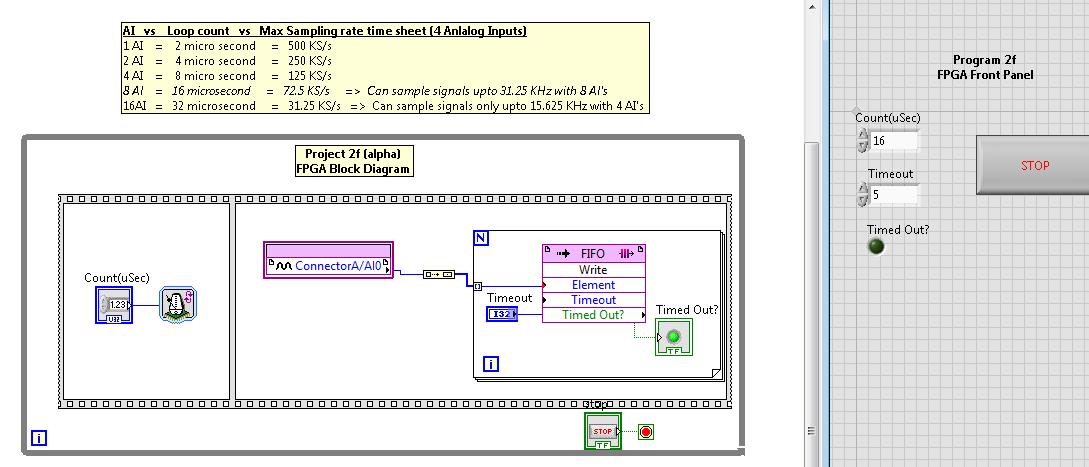

Though, i am able to measure signals upto 31.25 KHz from 8 AI's simultaneously (by using featurs such as using DMA FIFO and timer loop in FGPA @ 16 microsecond), i am facing a small issue.
When i measure a 10 KHz sine wave from function generator, my power spectrum shows a spike around 10.6 KHz.
Should i add in any information in Power Spectrum or did I missed any steps?

"Screenshot of FPGA Program"

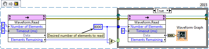

Assuming you are acquiring 8000 points of data everytime you try to read from DMA FIFO, you should make sure there is 8000 or more elements in the FIFO before reading from it. Reading 7000 elements and doing a FFT of 8000 elements is going to give peaks in the wrong frequencies. You might want to try this out:
VI Snippet (LabVIEW 2015): Ensuring elements inside DMA FIFO is more than the desired number of elements to read before reading them.
Also, try wiring a Zero constant the Timeout(ms) terminal to prevent DMA FIFOs from waiting in the loop. Instead, at the FPGA side, try to make sure there is no timeout occuring during the writing process to the DMA FIFO.
Hope this helps. Smiley Wink

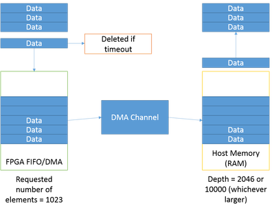

What does the Requested number of elements (i assume, that means DMA size or FIFO size) do when we right click and configure the FIFO proprty under Project Explorer. In my case, i configured the value as 1023
The requested number of elements option when we configure DMA/FIFO is the size of the buffer for the DMA/FIFO. Usually leaving the default value as it is will be sufficient as long as the rate of reading from the DMA/FIFO is fast enough to prevent overflowing.

For these two questions, I'll summarize the info from the link below into this: The depth of FIFO configured in RT host is the buffer size allocated in the RT host's RAM for the FIFO. Normally the depth is set to double the size of the FIFO set in the FPGA side or 10000 elements, whichever is larger.
For the flow of data from FPGA to RT via DMA FIFO, please refer to the image below:
In the image above, data is writen to FPGA DMA FIFO, which has a size of 1023 elements. The data is sent to the RT host's memory directly through the DMA channel, without going through the RT processor. The depth of the buffer allocated for the DMA FIFO at the RT side is 10000 elements, as LabVIEW automatically coerces to the larger value between twice the FPGA DMA FIFO size or 10000 elements. Data is then read out from the RT host VI. If the writing rate at the FPGA side is faster than reading rate of the RT host side, eventually overflowing will occur at the FPGA DMA FIFO, and new elements will not be writen to the DMA FIFO and will be lost.

I am trying to acquire 625000 samples/ sec from FPGA via FIFO to myRIO. Then, I want to have sum of every 2 minutes of acquired analog data to perform further operation and log the data into TDMS.
In addition, i want to perform Fast Fourier Transform on every 0.5 second chunk of data (31250 samples) and store it in TDMS file concurrently.
ON FGPA side
i managed to read data from 1 Analog Input at 62.5 KHz (16 microsecond). Then, I write the data into FIFO.
