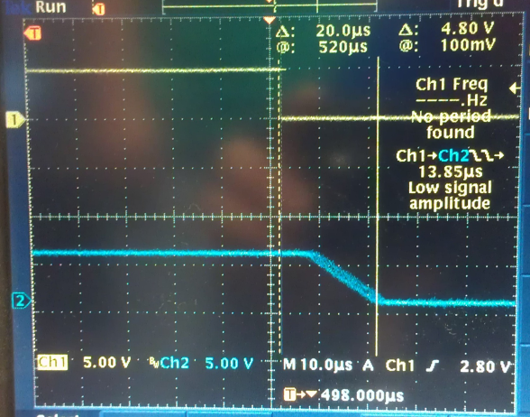

Hey,
For this question the best way to think about the myRIO hardware is as if it has two ports the MSP and MXP (don't distinguish between A and B on the MXP connectors).
The MSP AI, MXP AI, and Audio In (ie all the AI) share the same ADC.
The MSP AO and Audio Out each have their own DAC but share an SPI line.
The MXP AO has its own DAC and has its own SPI line
I tested the delay you were asking about by connecting AI0 to AO0 in the FPGA.  The delay between the source and the output signal was about 7 uS and when you include the skew of the output signal about 15-20 uS between the signals.
-Sam K

Hi!
Could you help me once again. I got some strange behaviour during above task implementation.
First of all I measured AI and AO time with attached snippet's. I got respectively 2 us (500 KSps) and 2.8 us (350 KSps). And this is absolutely ok.
Message 9 of 13
(12,272 Views)
Then I connected AI to AO inside one Loop in sequence manner.
And I got 4 us time which is smaller (about 1 us) than expected (2 us + 2.8 us  = 5 us).
What kind of optimizations was performed ? It is a little bit strange time.
ADC-DAC-seq-1 picture represents signal transfer through myRio.
