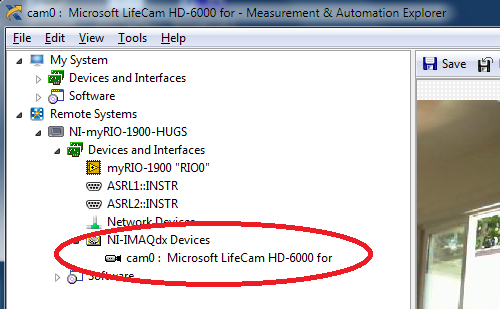

My old Microsoft Lifecam HD-6000 is properly recognized and preview works nicely in MAX. Have not tried any LabVIEW programs. I'll do some more testing....
(I got that as a Black Frinday deal many years ago for under $20 )
It even lets me turn off the annoying autofocus directly in MAX and focus manually with the slider. Nice!
