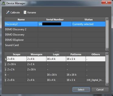

The name and serial number of the device connected may be required in some cases for the DigilentWF functions to identify which device to invoke, especially when multiple Digilent devices are connected to the PC. To find this information, open WaveForms 2015 and select “Device Manager” from the “Settings” menu:
Beware that the entire string listed in the Serial Number field is used to identify the device, including “SN:” at the beginning of the numbers.
Once the device identification is obtained, the WaveForms application should be closed to avoid conflicting commands to the device.
