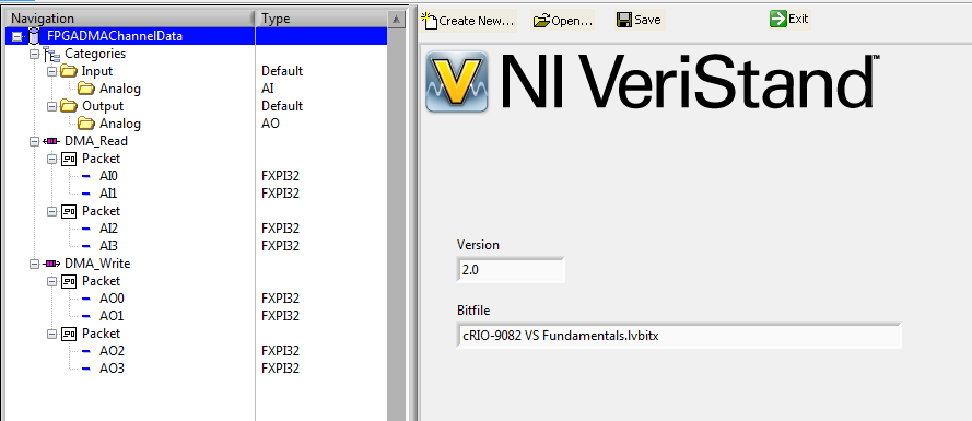

Open the <Your Project Name> FPGA.vi and remove the code that is not necessary for the hardware we have in our example. The final aspect of the Block diagram should be similar to the one shown in fig. 10:
Figure 10: Modified version of the FPGA VI: in the example we need only to access 4 AI channels from a 9215 and 4 AO from the 9263.
Modify the .fpgaconfig file
The LabVIEW Project generated before should include an FPGA configuration file called <cRIO Model (e.g cRIO-9082)><Project Name>.fpgaconfig. We’re going to use the VCE to modify it in order to include only the necessary packets.
Open the Veristand FPGA Configuration Editor by selecting Tools -> Veristand FPGA Configuration Editor from the LabVIEW Project menu. Then load the template fpgaconfig file and follow the steps listed below:
  1.      Remove packets and categories until the item tree inside vCE looks like the one shown below:
pic10_fpgaConfig_Final.PNG Figure 11: Content of the .fpgaconfig required by the example. Only packets related to 9215 (analog input) and 9263 (analog output) are included.
2.     If not present, add the bitfile name in the Bitfile control shown below:
Figure 12: Bitfile String Control where to insert the bitfile name associated with the fpcaconfig file.
!!!IMPORTANT: Compile the FPGA VI before loading the .fpgaconfig in the System Explorer.
Once you checked all these steps, you can upload the FPGA target inside Veristand. For additional information about how to load FPGA devices into the System Explorer, please refer the topic FPGA on the Veristand Online help.
