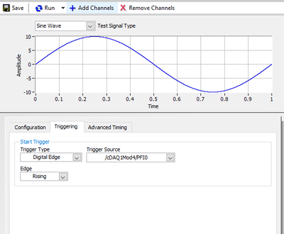

Hi Kevin,
Thanks a lot for your prompt reply.
I do can run the codes without any error following your valuable suggestions. However, when I directly connected the ai and ao channels, the reading data from ai doesn't match the writing data in ao. With NImx software, I can get the reading and writing simultaneously. I believe there is still some delay between reading and writing. Now I am using NI9264 (ao) and NI9205 (ai) incorporated in NI cDAQ9174. You are right that the ai has analog triggering while ao doesn't.
for the analog triggering of ai, i use the code:
readTask.triggers.start_trigger.cfg_anlg_edge_start_trig(trigger_source='Voltage')
 and it gives me an error:nidaqmx.errors.DaqError:
An attempt has been made to use an invalid analog trigger source.
Ensure that the trigger source you specify matches the name of the virtual channel in the task or matches the name of a non-scannable terminal that the device can use as an analog trigger source.
Property: DAQmx_AnlgEdge_StartTrig_Src
Corresponding Value: Voltage
Valid Choices: cDAQ1Mod4/ai0
Device: cDAQ1
Task Name: _unnamedTask<1>
Status Code: -200265
Here is the triggering setting of ai:
and  here is the ao
And I believe ai and ao use the same sample clock which I don't need to set it up manually, isn't it?
Thanks!
Ho
(4,690 Views)
The trigger error message is telling you that you need to identify a physical AI channel on the device as the analog trigger source, namely "cDAQ1Mod4/ai0"
AO and AI don't quite exactly use the same sample clock, but they both derive their sample clocks from a common master timebase.  To share the same sample clock you should UN-comment the part of the timing config for the AO task where it used to designate:
source='/cDAQ1/ai/SampleClock'
One difference is that the AI task's sample clock signal won't start pulsing until after the AI task has started acquisition.  In this case, that won't be until after the analog triggering conditions have been met.   When you configure this way, you won't need the AO task to be triggered any more.  The shared sample clock alone will accomplish the same thing timing-wise.
