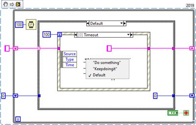

A simple Event Structure would work here:
Pressing the button causes the indicator to blink 10 times, otherwise it sits in the Timeout case and waits

This wouldn't work I have a loop with a lot of things happening in it and sometimes I want to run non-stop and sometimes step. My solution works very well. If the Step button is true then it pauses at each iteration, if false, it completes the loop.

I think @   approach would work. That is a fundamental idea. Below is my attempt to build upon @ 's idea.
EDIT: Improvements (disregard the snippet above)

My bad, I misread it.
This also possible with what @ suggested. Check this VI snippet.

Where's the for loop? Can you upload this so I can download it.
Message 8 of 16
(1,680 Views)
I do not recall putting in a for loop. Attached block diagram is a VI snippet, you can save it on your local hard drive and then drag it on to your block diagram and you will have actual coding populate on your block diagram.
But if that does not work. Attached is the VI file.
Message 9 of 16
(1,673 Views)
Well there's the problem, it has to be in a for loop as the program is already built with one and it's too large of a program to make such a drastic change, I think.
