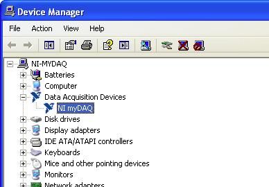

The NI myDAQ Troubleshooting Code requires that both NI-DAQmx 9.1.6 or later and NI ELVISmx 4.2.2 or later be installed on the computer, and that the NI myDAQ be plugged into the computer.
If you are unable to communicate with the NI myDAQ, complete the following steps to verify that the NI myDAQ is successfully recognized by the computer.
Note: Before starting this process, close all NI software completely.
