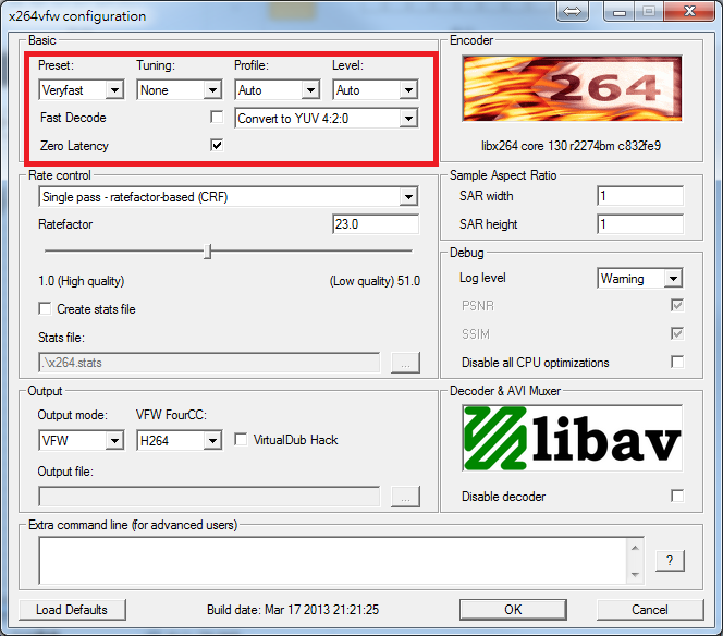

The interesting thing is that the x264vfw actually works. I tuned the configuration as follows.
Be sure to make the basic setting to very fast, or the encoder cannot catch up with the 30 fps.
Zero Latency has also need to be checked up to eliminate warning message.

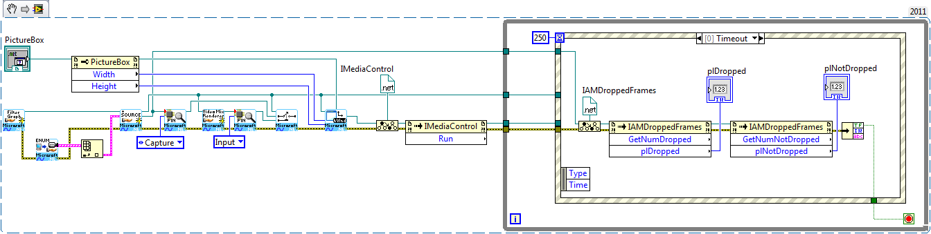

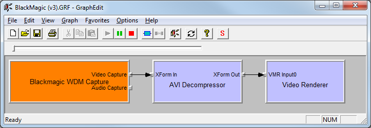

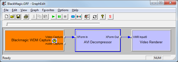

Okay, I was able to get video using GraphEdit (see below) and now I am trying to make the same connections in LabVIEW.
I took the Acquire Video example and inserted a new VI from the AVI Decompressor block (AVI Dec block, diagram below) and changed the renderer from "DirectShow - Create Video Mixing Renderer9.vi" to "DirectShow - Create Video Renderer.vi" but it still doesn't show video. What am I still missing?
Hello Bruce,
Add ->
right after IMediaControl -> hit "Run" -> open GraphEdit -> File -> Connect to Remote Graph.
Attach image.
-Artur

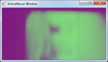

I connected it and ran the VI, went to FilterGraph and the Connect to Remote Graph window doesn't show any remote graphs.
When I do what was suggested in the P.S. the colors are not right.

We will address colors later...

The AVI Decompressor was actually inserted automatically in the FilterGraph.
I have not registered the dll's yet because my company is very restrictive and requires permissions to be granted for my computer. I'll let you know when I get the dll's registered.
So I registered the dll's for FilterGraph am now able to view more of the properties in FilterGraph and things seem to be working a bit better in FilterGraph, but when I try to connect to a Remote FilterGraph, I see the remote graph, but when I select it I don't see the full chain I'm expecting.
Ok,
Looks like you have pin names mismatched. Try to get pins by name (get actual name from GraphEdit or enum pins) instead of "Capture" or "Input". Also, check if you have any errors adding AVIDecompressor, it should be somewhere on GraphEdit if added properly but not connected.
