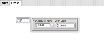

1. What is a good way to display those configuration to a user? As a shown below, I modified the Settings Editor from the CML template and have arrays of the cluster so the user can add elements or empty the array. But I was wondering if there is a better way of displaying it.
2. Once I have the settings saved into a file, how should the clones access that information? How can the clones know which settings to pull from?
3. What would be a good way to keep the pairing between the instruments and the DUTs, and varying equipment in between them (mux, etc.)?
As you can see in the settings screenshot, I ask the user to label the DMM and use that label in the UUT settings. When I start the modules, they return their module ID, which I store in a state cluster array within my main program. So I can keep track of what's the UUT module ID, and the corresponding DMM Module ID. Is there a better way of doing it?
This looks simple enough, but it doesn't do any checking/validating.  Perhaps this needs to be displayed as some sort of table that automatically checks/limits the user from multiply selecting things they can't.
What we do at WiS, is upon every DQMH module launch, we immediately send down the settings/config the freshly launched DQMH module needs.  So I presume you'll have some higher module that's launching things - send down the config to each respective clone right here after launching.
Perhaps look at using Sets - this will only allow unique values so it will help prevent the user selecting multiple options that are not allowed.

At HSE, we usually stick to the rule of a single configuration file per module. For cloneables, that would mean that the single file has one section per expected clone.
For your specific situation, I could imagine a clone manager (see this discussion) might be helpful in managing the configurations, starting and stopping clones and handing over all the information those clones need.
As for the UI, the array controls don't do much in terms of user experience. Maybe go with a Multicolumn Listbox as Chris suggested, and then find a nice way to let the user add/edit entries (either a popup dialog or populating some controls next to the MCLB when a user selects a row)...
