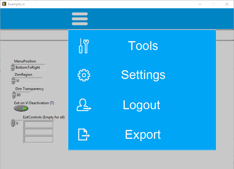

I modified the code to separate the GUI in a simple vi and the Code in a ToolbarMenu library, which can used with different menus.
And I copied the Hamburger Button & Menu Elements to demonstrate the function.

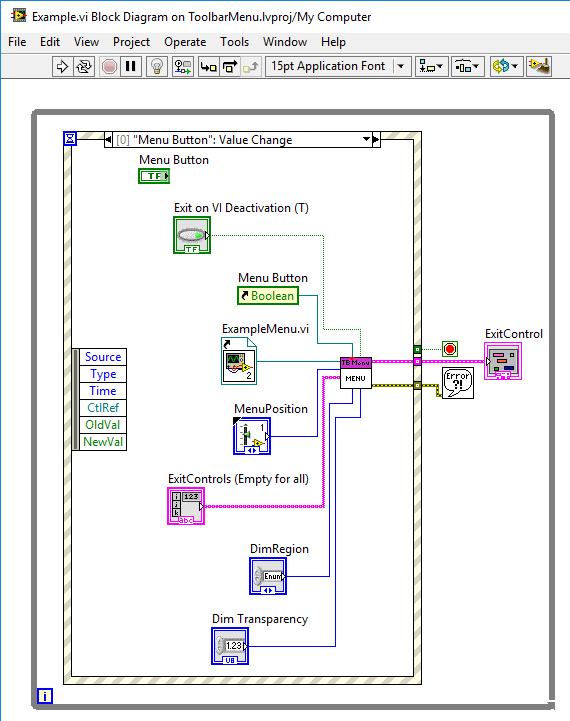

Usage
In the Event Case of the Menu Button call ToolbarMenu.vi.
It need references to the menu Button and the Menu vi.
The other parameter are optional:
Exit on VI Deactivation (T): If True (default) the VI Deactivation event will exit the menu with empty result.
Position: Set the Position of the Menu relativ to the Menu button at top or bottom of the button and show to right or left side.
ExitControls (Empty for all): The names of the controls in menu VI's cluster to exit the menu. Leave it empty to exit at every control.
DimRegion (VI): A dimmer vi is used to prevent click events at the underlying front panel. Set size to: VI (of menu control), Screen (all monitors) or only to the menu control.
Dim Transparency (90): Set the dim transparency of the black dimmer vi: 99: full transparent, 0: full black
The result is a cluster ExitControl with:
Name: of the changed control in the cluster
Value: the value of the control
Example
Screenshots from Example.vi:
I attached the Labview 2013 ToolbarMenu project. Labview 2013 is the first version with the used Application event VI Deactivation.
It used some vi's from OpenG Application Control Library.
