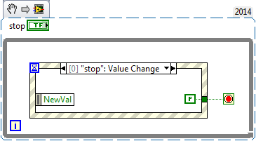

Consider the VI shown below. The Event Structure has only the single case shown. The Control 'stop' has two states, TRUE
and FALSE
and the initial value of FALSE.
The user runs the VI and performs a single left mouse click and release on the 'stop' control. Which of the following might the Mechanical Action of the 'stop' control be set to for 'stop' to automatically return to FALSE following the left click and release.
NOTE: Mutilple answers may apply.
a) Switch While Pressed
b) Switch While Released
c) Switch Until Released
d) Latch While Pressed
e) Latch While Released
f) Latch Until Released
