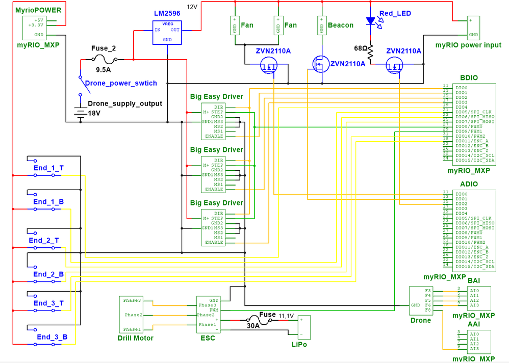

Main circuit board:
In order to have an organized electronics compartment and have easy access to plug in the steppers, end stops, fans, GPS beacon release, the Roll alarm LED and the in- and outputs from the drone and myRIO a main circuit board has been made. The circuit board acts like a motherboard for the drone and controls all the functions of the drone. The power is supplied from the drone’s 18V output and converted down to 12V. The board receives 5 inputs from the drone’s flight controller, which is then send to the myRIO and processed in the VI’s. After processing the myRIO sends out the orders and enables the requested function.
The construction of the motherboard was made easy by making the entire circuit in NI MultiSim 14.1, in order to secure that everything was connected properly, see the final schematic underneath.
Schematic of the circuit made in NI MultiSim 14.1Schematic of the circuit made in NI MultiSim 14.1
