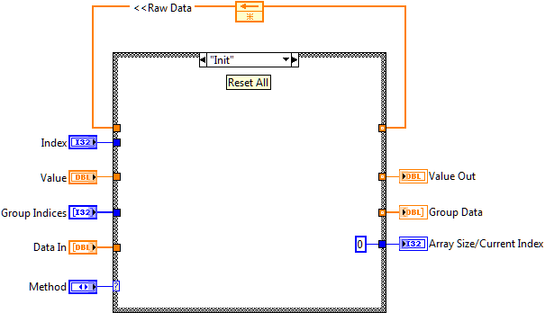

The core VIs consist of two VIs for each data type supported by the CVT. Each of these VIs is configured to provide a set of functions or methods to their callers and uses shift registers to store data between calls to the VI.
The first of these VIs is the data storage VI called MemBlock. It contains a shift register which stores all of the CVT data for a single data type. It contains a few basic functions (Init, Read, Write) that provide access to the data. Different variables of the same data type are stored in an array in the MemBlock VI. To access an individual variable the caller needs to know the index of the desired data item in the array.
Figure 3: Implementation of the CVT Memory Block Core VI

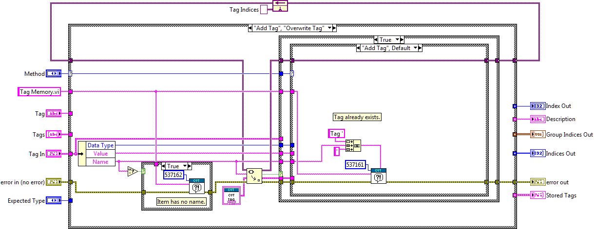

The second core VI (Tag Memory) maintains a list of properties for each of the values stored in the Memory Block VI including the name and index of each value. This VI enables an application to retrieve the index in the storage array using the variable name. It also stores a string description for each value.
Figure 4: Implementation of the CVT Tag Memory VI
