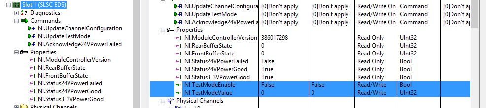

It is recommended to target a SLSC board when the chassis running because this would allow the SLSC EDS to read the capabilities features in the board. If you do that, then the module in the specific slot will return the specific capability in the specific slot:image.png

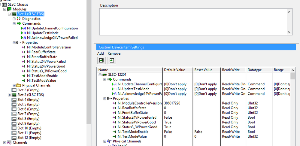

Notice that this specific board had two extra channels customized for it own use. And if you try to target a SLSC-12201, its capabilities are read and made available for VeriStand:image.png
