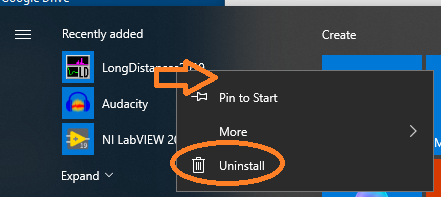

I guess my problem is related to my first post (Not following any instructions (point 5 :D), but following typical procedures).
Let's assume they don't have any existing NI software and want to uninstall whatever they put on minutes earlier because they don't like me or my programs.
The start menu has an "uninstall" right-click item added by windows 10, so most might start there. Clicking this opens the software control panel and my app is nowhere to be seen and nothing happens. They might think that NIPM relates to it and uninstall that instead (Yes, there will be warnings, but if they ignore them, my software will probably be stuck there forever. ;D!)
Maybe this is something that could be better implemented in windows 10 such that if I click "uninstall", NIPM would open instead. Not sure if that's even possible.
I guess they would need to open NIPM, uninstall everything, them uninstall NIPM as a last step.

I haven't tried this, but I was wondering if you could use a custom action to manually add your own option to Add\Remove software and set the UninstallString to use the nipkg.exe command-line to uninstall your package.
https://nsis.sourceforge.io/Add_uninstall_information_to_Add/Remove_Programs
