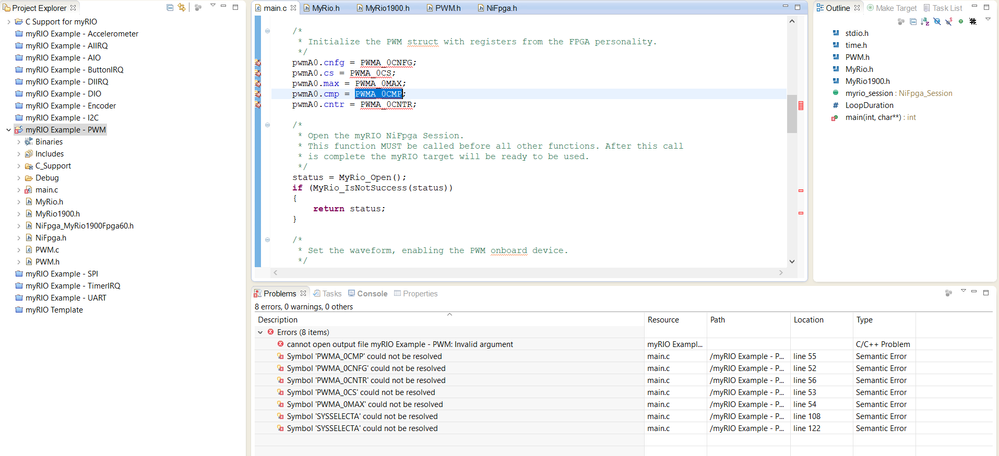

I take that back. It built once... ran into that issue and then went to get coffee, came back, cleaned and built again and this happened.Later Issues Part 2.PNG

The unresolved symbols you're seeing the source file are expected (Eclipse isn't always the best at tracking down supporting files to be honest, and it's likely that some of the header include paths are missing). The bigger concern would be that first error (the "cannot open output file..."). Typically I recommend looking at the console rather than the Problems tab as Eclipse tends to be over zealous with the Problems it reports. Are you seeing build errors in the console when building?

Build seems to somewhat be working, the console tab doesn't show any errors and completes the build. However the problem tab has 50 errors:50 errors.PNG

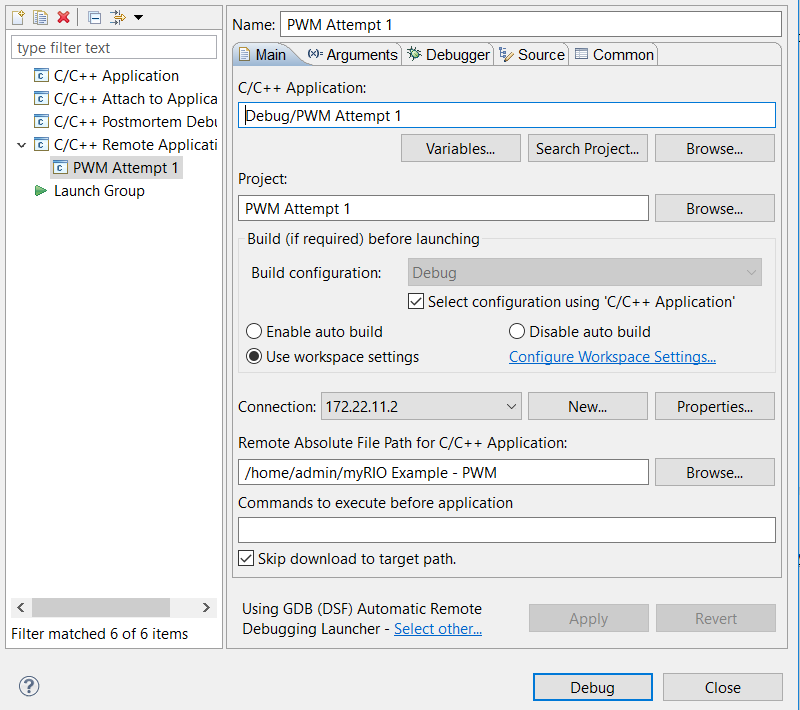

Can you share the Debug Configuration Settings? I think the issue is the Remote Absolute File Path in that configuration. Try setting it to include the binary application name. E.g.:
/home/admin/myRIO Example - PWM
I also changed the project name to PWM Attempt 1... that shouldn't change anything right?

It does actually change things, as it would change the built binary name from Eclipse's tracking perspective. So in your case that Remote Absolute Path should be: "/home/admin/PWM Attempt 1"
