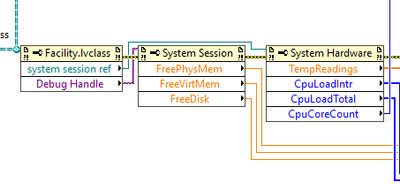

we added a resource monitoring to the system and since then we havent got this problem anymore.
it happened to us maybe 2 times.
(1,492 Views)
Could you help me with detailed steps
(1,486 Views)
sorry for the late reply.
that is how i did it.
(906 Views)
