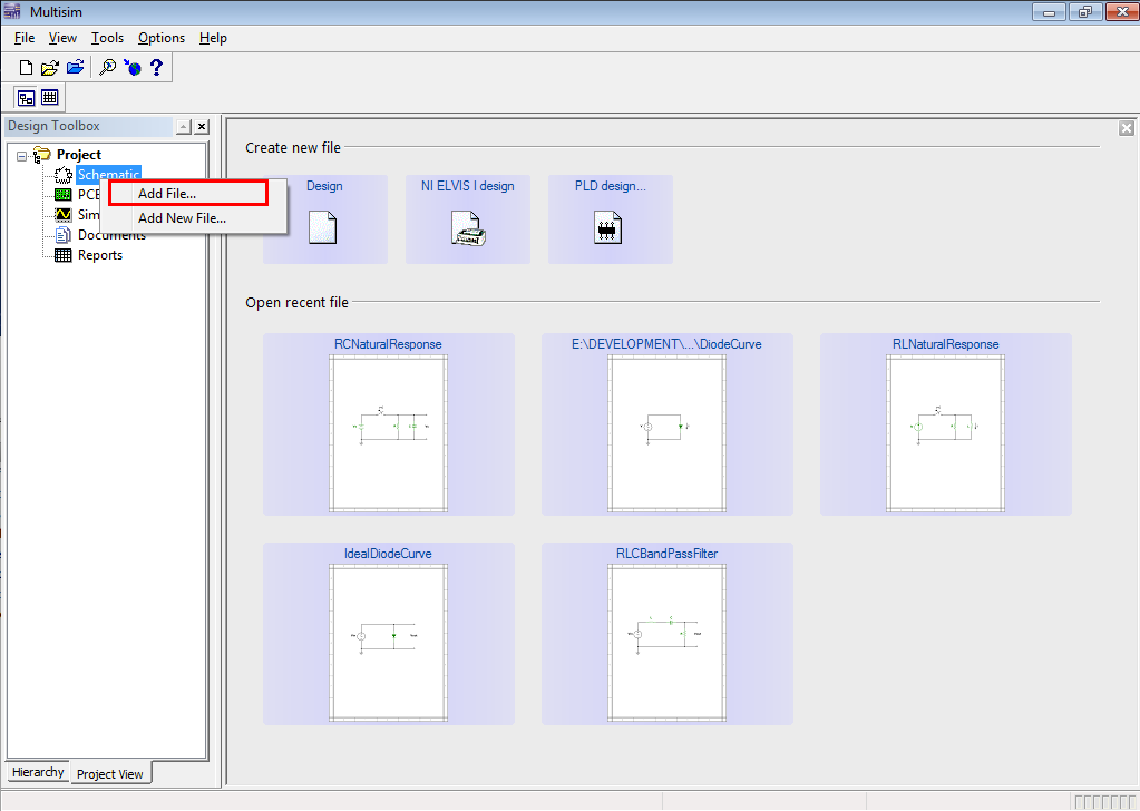

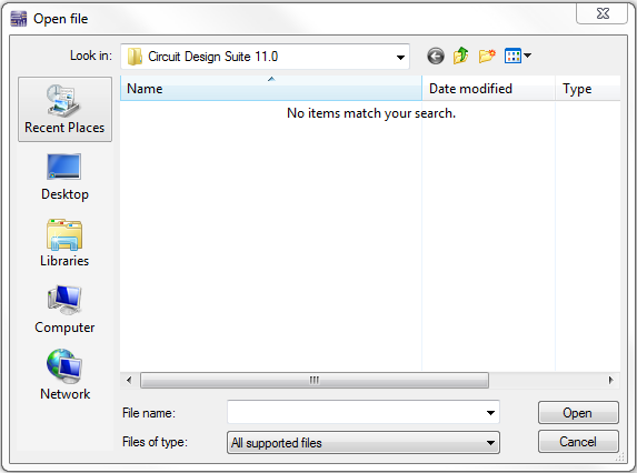

I've been asked quite a few times how to easily upgrade files from an older version of Multisim to the latest version. Years ago, I created a simple utility to open and save the files in a single directory, but since Multisim 11, you can use Multisim directly to upgrade files to the latest version.
Multisim 11 introduced packing projects into a single distributable archive. Project packing also included a lesser know feature: Upgrade project. Upgrade project converts all Multisim files in a project to the latest version - all in a single step. This is great if you have a large number of Multisim files (for example files developed for a course) that you need to upgrade. Even if you don't have a project, you can create a temporary project that you use to upgrade your files.
Follow the steps below in order to upgrade a set of files to the latest Multisim version.
1. Click File > Projects and packing > New project
2. Accept the default project
3. In the Project View, right-click Schematics, and click Add File...
4. In the Insert Files to Project dialog, select the files you want to upgrade. Note you can use Ctrl and Shift to add multiples
5. Finally, click File > Projects and packing > Upgrade project
Wait a few moments and the files are upgraded.

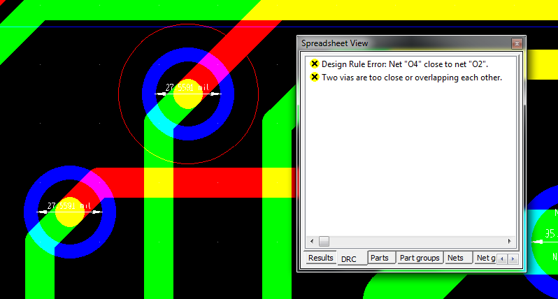

Version 12.0 includes a new DRC check for overlapping vias. (Ultiboard always had a check if copper objects were too close such as vias were to close, but there is now an additional check specific for vias that will detect if the vias are connected.) Now, if two vias are within the via-to-via clearance and are drilled such that they go through at least one common layer, Ultiboard will highlight this condition as a DRC error.
As before, if you don't want to see this class of errors, you can hide the error using the Filter Manager by right-clicking in the DRC tab and selecting Filter Manager.

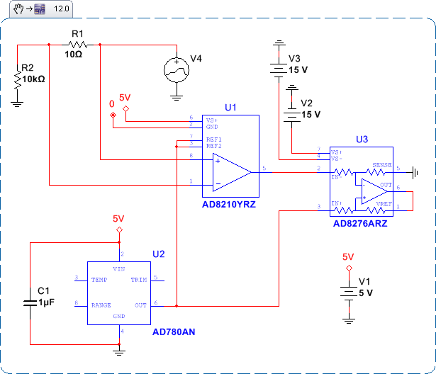

I've been recently looking into motor control designs, widely used in energy and automotive applications, and the reason for that is to learn more about how the new capability of accurate system simulation at desktop level using Multisim 12 and LabVIEW 2011 can be successfully implemented in this application area.
What caught my attention is the numerous pure analog circuits that are essential for these types of designs (motor control), apart from the main switching plant that requires digital logic/FPGA control. A good example is a high-precision current monitoring circuit. I came across this circuit that simplifies high side current monitoring by providing a high voltage interface and bidirectional current monitoring capability across a shunt resistor while using a single supply.

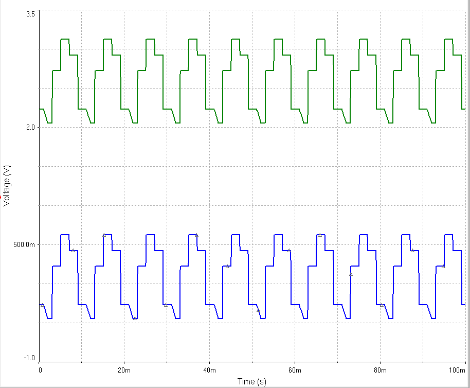

In no longer than half an hour, I was able to lay-down a schematic, simulate, and validate a design based on an Analog Devices circuit note and using their industry-standard SPICE models available in the Multisim's database for the following parts:
  • AD8210:  High Voltage, Bidirectional Current Shunt Monitor.
  • AD780:  2.5 V/3.0 V Ultrahigh Precision Bandgap Voltage Reference.
  • AD8276:  Low Power, Wide Supply Range, Low Cost Unity-Gain Difference Amplifier.
The circuit schematic is shown in the following snippet (png image) which you can drag and drop directly into Multisim 12.0:
The following graphs show the transient response of the input load current and how the integrated current sensing device AD8210 responds and generates a proportional voltage that is level-shifted at the ouput stage of the AD8276.

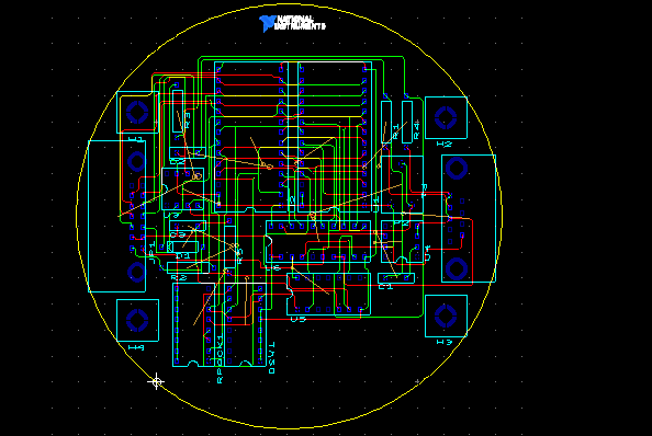

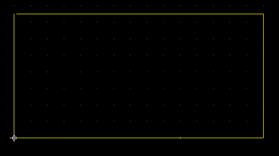

The board outline in Ultiboard delineates the boundary of your design. Parts are usually placed within the board outline, and power planes end at this boundary. The board outline therefore needs to be a valid closed shape for Ultiboard to do a variety of things, such as automatically place parts within this boundary. (Without a boundary, how do you place things inside it?) Typical situations that arise that cause an incorrect board outline would be line end points that are not quite touching (as in top left corner of the image below), or overlapping lines, and these tend to arise when importing the shape from another program.
This release has two small but very useful improvements to help with these situations.
Reporting Problems
Previously, Ultiboard would detect the problem and tell you about it, but didn't provide any help if you wanted to fix the problem yourself. It was up to you to scrutinize your design and figure out where the problems were. Now, when Ultiboard detects an incorrect board outline, you can get a list of all of the problems to quickly figure out where the problem is.
Automated Fixing of Problems
In some situations, Ultiboard would offer to automatically fix problems, and this has been completely rewritten to give much better results. It will now detect and merge overlapping line segments. It also now maintains orthogonality of segments so vertical lines remain vertical and horizontal lines remain horizontal.

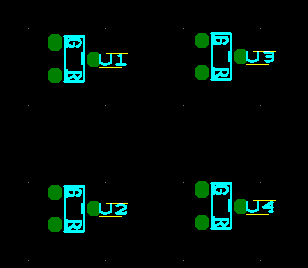

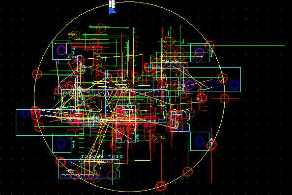

When you select a number of different objects in Ultiboard, then rotate that selection, the selection rotates about the center of the selection. This is pretty important because if your selection contains traces and other objects. If instead of rotating as a group, Ultiboard instead rotated about each objects individual center, rotation might turn
into
Yikes! Definitely not what you would usually want. So Ultiboard does the right thing and rotate about the centre of your selection. But suppose you do want to rotate about individual centres, for example because you want to rotate a few of RefDes, as in the following case
In this case, I want to rotate them about their individual center. Or suppose you wanted to create the second image above. How would you do that? Before version 12.0, you would select each object individually and rotate it, but now there is a better way.
  1. Select the objects to rotate
  2. Edit > Orientation > Rotate...
  3. Select Rotate about individual centers
Click OK, and you'll get

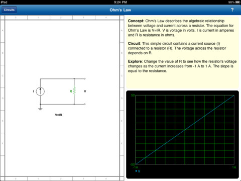

As part of the R&D group, I'm not the one usually announcing new products. That's usually better left for our marketing folk, but today, I'm making an exception.
I'm excited to announce Multisim Circuit Explorer for iPads available on the iTunes App Store. Multisim Circuit Explorer is what I call a "textbook companion," and allows students to gain insight into how various elements in a circuit affect the circuit behaviour. The truly innovative and cool part of this product is the immediate feedback. When modifying a component, whether by selecting from a list or sliding a control, the graph updates immediately to show the truly dynamic circuit behaviour.
There are 18 circuits in this release, covering RLC basics, filters, and op-amps.

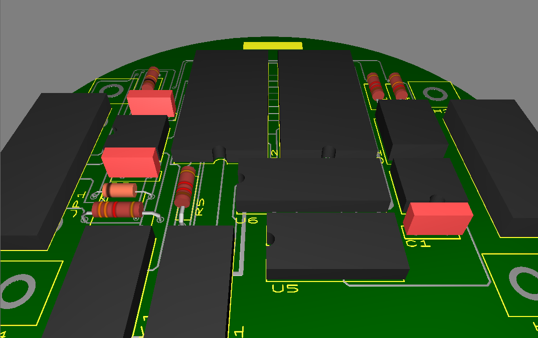

Last week, I talked about how to view your PCB design in 3D. This week, I’ll deal with a bit of a tougher question – what happens if you create your own footprint in Ultiboard, and the part doesn’t have any 3D information associated with it?
Like I said last week, being able to see a PCB in 3D provides an intuitive way of viewing your design. In Ultiboard, adding 3D information to a footprint is easy, and it's a good idea to do this whenever possible. So let’s get started!
First, open Ultiboard and find the part you’d like to edit. If you haven’t created a footprint, but would just like to edit the 3D information of an existing component, you can copy a component from the Ultiboard Master Database into your own User Database.
1. From the toolbar, go to Tools » Database » Database Manager.
2. Find the footprint that you would like to add 3D information to, and click the edit icon, as shown in Figure 1.
Figure 1: Selecting a part to edit
3. You are now in Footprint edit mode. In the Design Toolbox, switch to the Layers tab, shown in Figure 2.
Figure 2: The Layers tab of the Design Toolbox
4. Double-click the 3D-Info Top layer to make it the active layer. It should be highlighted red to indicate that it is now the active layer.
5. If you’re simply modifying the 3D information for an existing part, move on to step 6. Otherwise, if you’re adding 3D information for a new footprint you created, select Place » Shape and select the shape you want for your component, such as a circle or rectangle. Place it directly over the silkscreen of the object.
6. From the toolbar, go to Edit » Properties. This will open the Components and Sheet Properties window.
7. In the 3D data tab, make sure the Enable 3D for this object and the Use 2D data to create 3D shape checkboxes are both selected, as shown in Figure 3.
Figure 3: 3D data tab of the Part and sheet properties window
8. From here, you can change 3D settings for this part. Look under each of the sub-tabs (General, Material, Pins, and Cylinder) for more options.  Anything you change will be automatically visible in the Preview area on the right of the window.
Adding 3D information for parts in Ultiboard is relatively simple, and can help you visualize what a board will look like when manufactured.
