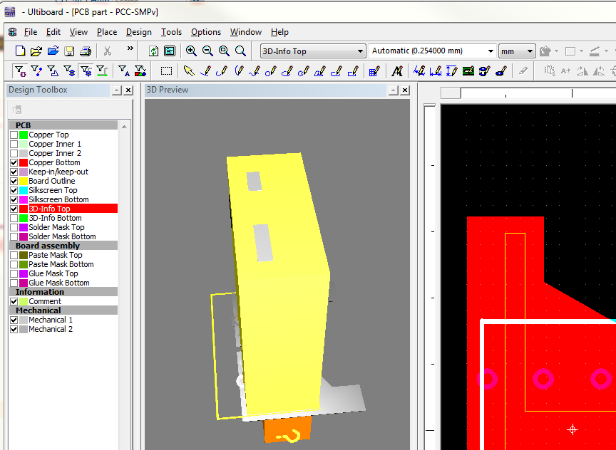

When I edit a PCB part footprint in UB I see I have access to 4 layers.  If I want to add structure to this part on more than 4 layers is there any way to do it?

This is V13 beta power pro, but I think it was no different in V12.
Edit footprint screen.  Note 4 layers.
Project editor 2 layers:
Project edit 6L:
Footprint edit.  Still 4 layers:
I wish someone would fix this forum to accept in-line snipped images.  It's a pain to have to save each screen shot and then attach them.  And the attachments only allow 3.

If you are in the Footprint Editor, you have 4 layers to work with and it doesn't matter if you set  the number of layers in the Sheet Properties to more than 4.  I am not exactly why this is the case.
The work around is to edit the part using the In Place Editor by placing the part on the design then click on it then select Edit>>In Place Editor.  The In-place Edit should have the same number of layers as you design.

Edit in place worked.  When I save to the database and edit it in the footprint editor the extra layers still do not show up, but when I place the part in the design they are there.
Seems like a bug (or deficiency) in the footprint editor, but the workaround works.
The right way would be to allow specification of multiple layers in the footprint edit tool, though maybe you need a warning that pops up if a multilayer part is placed on a design without the proper layers enabled.
A menu pick in the footprint editor to replicate structures on specified design layers may be an even better way to do it.
