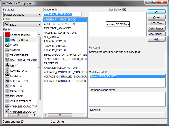

>The easiest way to do this is to place an Arbitrary SPICE Block, (located in Basic > BASIC_VIRTUAL > ARBITRARY_SPICE_BLOCK), and set the global variable there.
In Multisim 10.1 Pro, I could not locate "Basic > BASIC_VIRTUAL > ARBITRARY_SPICE_BLOCK" could this have changed recently? There is not reference to it in Help either.
Message 8 of 13
(14,015 Views)
Have a look again. I checked all Professional versions of Multisim and it was there.
In the component reference, it is topic Basic Components > Arbitrary SPICE Block.
