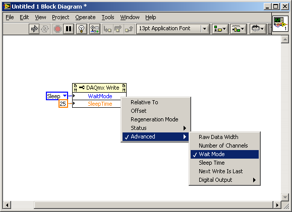

Pretty nice, really.  And it makes more sense than simply throwing an error like I expected.  So one last little thought of something to look for and try.  Even though there's a CAR filed on the issue (acknowledging an internal implementation problem), I wonder if there might be a workaround analogous to something I've fiddled with for AI tasks.  There's a pair of DAQmx Write properties that let you set the "Wait Mode" to 'sleep' and then set a sleep time in msec.  Maybe one of the other modes ('poll', 'yield') is default and the CPU utilization issue can be avoided by explicitly setting the mode to 'sleep'?   Here's a little screenshot:
20731i7196B59DC14654CB
Hope it helps, and thanks for the post back with those links!   That's a useful tidbit to know, that DAQmx Write
is smart enough to wait for buffer space rather than throwing an immediate error.
