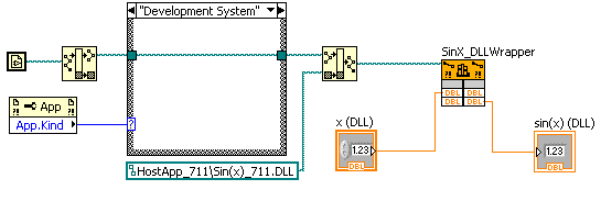

The second way is using DLL as mentioned above:
In your DLL you should have "wrapper" to old version VI (DLL written with same version, of course):
Now you can call this DLL dynamically from LabVIEW 8.5.1:
I have attached example for 7.1.1 / 8.5.1. Sorry, I haven't other versions of LabVIEW at this time on my PC.

>  Is there a way to dynamically load a dll? We had trouble with that
before. If there is one, we can try using dlls instead of subvis.
Yes there is. In 8.2 it's a lot easier then in 7.1. Create a Call Library
Function Node, and dubble click it to configure it. Specify the prototype
like you'd always do, but in 8.2 there is an option "Specify path on
diagram". If you select it, you can use a path constant or control to
specify which dll to call.
If you also want to specify the function, you need to use windows API's. See
http://forums.ni.com/ni/board/message?board.id=170&thread.id=39381&view=by_date_ascending&page=2 .
Wiebe.
