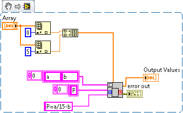

I have Labview Full Development system . But using Eval Formula node.vi . I can't give formula of array variable and array input. My formula is P=a[0]/15-a[5]. where P is output variable and a[] is input vable. So I need to give array input as well as array variable.

Just out of interest, why are you using a Formula Node for this simple calculation? You could create a simple subVI that performs this calculation with the array a as one input, the index i as another input, and an output value P calculated using simple index array, divide and subtract functions.

@Muthu92 wrote:
Ya. Thank you sir.
I have to agree with the post above mine, for a simple calculation it is likely faster, easier, and simpler to read for others viewing your code if you just do all calculations in LabVIEW.
If your actual calculation is significantly more intense and/or you insist on using a formula node, then I have a half-solution.  From what I understand, Eval Formula Node VI does not allow you to pass entire array inputs.  You have to pass variable names and values in a one-to-one manner.
To get around this, rename the variables in the function (i.e. a[0] == a, a[5] == b) and index your input array using LabVIEW code before even using the formula node.  It is a ltitle messier, but this will allow you to extract the elements from arrays as you need them, and then you can just reference them in the formula node by a different name:

Thank you for your reply. It is very useful for me.  But i can't give conditional operator in that operator. It is showing error.
My Test cases
A[0]+A[1]>150
A[31]-50 <100.
My Test cases
A[0]+A[1]>150
A[31]-50 <100.
If those are your exact statements, then they don't make sense in a formula node.  You have to use them in an if-statement or some other type of control logic.  This mimics text-based programming languages such as C... See here for instructions on formula node syntax: http://zone.ni.com/reference/en-XX/help/371361G-01/lvhowto/formula_node_syntax/

I stand corrected.  After trying to create an example and digging through the LabVIEW Help, I stumbled across this:
Differences between the Parser in the Mathematics VIs and the Formula Node
The parser in the Mathematics VIs supports all elements that Formula Nodes support with the following exceptions:
Variables—Only a, a0, ..., a9, ... z, z0, ..., z9, are valid.
Logical, conditional, inequality, equality—?:,, &&, !=, ==, <, >, <=, and >= are not valid.
Functions—atan2, max, min, mod, pow, rem, and sizeOfDim are not valid. You can use these functions in a Formula Node or use their corresponding LabVIEW functions.
So it DOES NOT seem like Eval Formula Node can do conditionals like you want.  I would just implement them using a LabVIEW based algorithm after all.  Trying to out smart the formula nodes to avoid simple LabVIEW code is just too much of a hassle 😛
