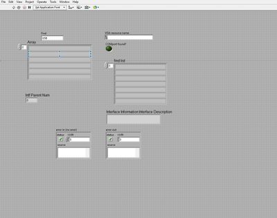

Hi LabView-guru's,
I would like some help regarding
finding and debugging root cause error-message: "Hardware not detected".
How to detect which hardware is missing? I use NI Max to detect faults in administered devices.
any help is most welcome,
LabView-novice
(1,750 Views)

Hi novice,
When the indicator "find list" is empty then there are no (VISA) devices available…
Where does that one-button-dialog comes from? Can you attach (real) code of the VI in your first image?
This code contains the information which hardware is needed to perform its operations…
Which (available) devices are shown in MAX?

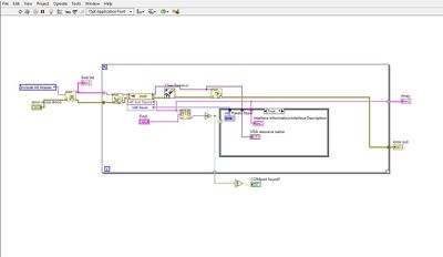

The problem with instruments on a Com port is:
  1. The vast majority are not IEEE 488.2 compliant so they don't respond to a *IDN? query
  2. NI-Max "knows this" and does not automatically do a *IDN? query on Com ports it finds, even for instruments that are IEEE 488.2 compliant and respond properly to a *IDN?.
I wou use VISA find resources to find every Com port then write some code to determine if the instrument is present and what Com port is is on.
