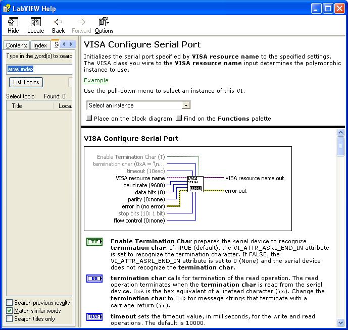

I think argument 1 in VISA configure serial port is the timeout value. Was this value changed?

here is the vi I use. I am not use which input is arg 1.

If you open up VISA Configure Serial Port.VI you will see a property node used to set the values.
"Time out" is the first argument (top) and is the first arg that it tries to write to and there for the first and only error.
Check that your "VISA resource name" is valid or is gettnig changed somewhere else.
For if the VISA is not valid the error you will get will be when it tries to write to the 1st arg.

I am still leaning to an invalid VISA Ref. It could be invalid because (as metioned earlier) another app has control of the com port (MAX or Hyperterminal)
Run the VISA Configure Serial Port.vi as a stand alone selecting the VISA resource name from the drop down to see if you still get an error.
Next in your "setup Serial.vi", put a Not A Number/Path/Refnum? check on the output of the VISA Configure to see if it is valid.
The first time you run your VI the input will be invalid, but if it point to a valid com port that LabVIEW is able open, the out put VISA should then be come valid. Depending on your VISA clean up setting the next time you run it the input VISA might be valid before call the VISA Configure.
