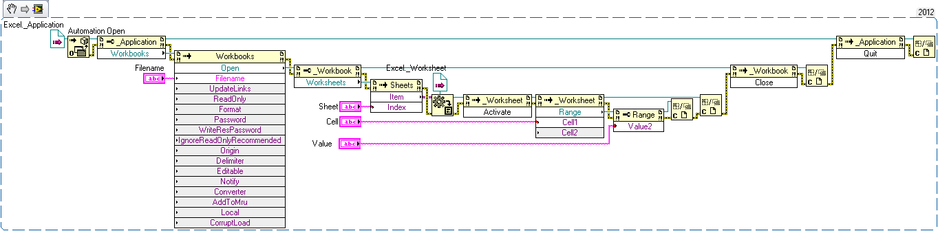

Thank you for helping me on this. However I do not really understand how does ActiveEx work. I have created a Vi according to the picture that you provided but there was some error in running the file.
Below is my own VI that I am trying to create. It consists of multiple string inputs which I am trying to input each into an existing file. I have created a separate txt file which has the cell numbers. I am trying to allocate each string into each respective cell in an existing file. I am currently having the problem of doing this "allocation" of each string as I do not have the microsoft office tool kit. Is there any other way for me to do so?
Also, I would like to save the newly created file as a new file with the name as seen in my VI. How would I be able to do it?
Please help me as I am stuck here but do not know how to continue
(4,537 Views)
The attachment posted is a snippet.  It's a png file with embedded Labview code.  Drag and drop this image to your desktop and then drag it into the block diagram of a VI.  It will re-create the code for you.  This one is Labview 8.6.
