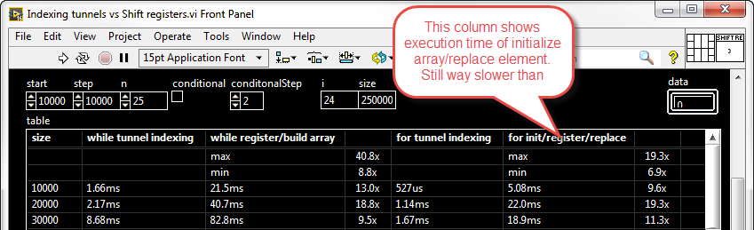

Just to be clearer, I am quite aware of the basic while/for loop advantages/inconvenients as well as the many different optimal ways of managing arrays.
I was mainly concerned about why can't LabVIEW optimize an initialized array/replace all elements to be as fast as an indexing tunnel. If you look at my example code, the for loop part is comparing exactly this, indexing tunnel vs initialized array/replace all elements. I am also a bit curious about the way the while loop array resizing algorythm are actually working.
Thanks to all who contributed, this is and was not really an issue for me, more of an ongoing learning LabVIEW experience that started 22 years ago 🙂
Fot those curious I have attached a LV12 version of the code used to explore the issue, don't forget that this is not production grade code 🙂

jacemdom - you got parts of the shift-register based solution wrong (and had only put it into the for-loop version). I would also turn off debugging when doing such tests. Attached is a revised version (backsaved to LV2012).
Preallocating the array at its maximum size, then resizing it to the resulting number of elements, makes the shift-register based solution more comparable to the auto-indexing function. With large arrays and the conditional factor low, it is even faster (but uses more memory than needed, which can also partially explain why the conditional has an edge, but not fully...to really understand why the auto-indexing function mostly wins requires more under the hood knowledge than I have...). Here is one example test:
As you can see I have turned on condtional (that's what we are interested in here anyway), and have ramped up the array size. This is also with the corrected code of course.
The conditional auto-indexing  has an algorithm that resizes the array "intelligently" (that is, it got such in its second revision, at first it too was a "stupid" build array solution), typically with increasing step sizes (I'm not sure of the exact implementation, but one approach is to double the size every time it needs a resize, so when the array hits a limit at 4 elements it will go to 8, at 8 it will jump to 16 etc...perhaps with a max (if knowable) as a cap on the resizing. This way even very large arrays will not be rezied that many times, and if the resulting array turns out to not be that large the algorithm will not have wasted much memory (at worst by a factor of 2). We could of course implement a similar approach with shift registers (to save some memory when the result is less than half of the max), but not as efficiently as the native LabVIEW code.
AristosQueue for example can probably reveal more about the way this is actually implemented in the condtional auto-indexer(?). I remember I discussed tha lack of speed with him when the first version of it came out (too late to fix it until the next major version though back then).
