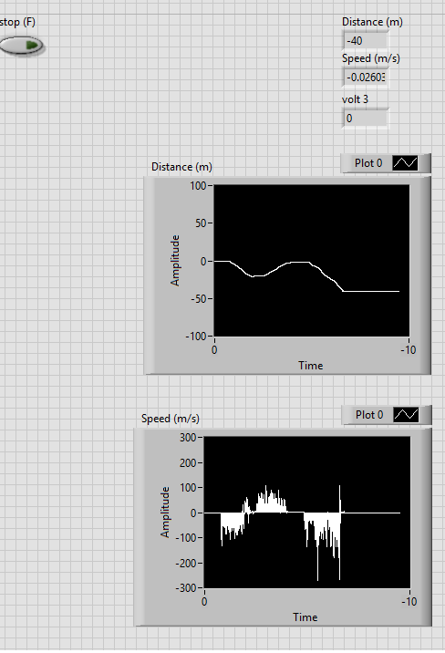

Hey I've been trying to take the derivative of some measured data from a digital rotary motion sensor but I'm having a few problems. It would seem since there are so many data points there are alot of areas on my Distance graph are flat for a very brief period of time making the derivative very small. Which I'm assuming is why the graph looks like this.
If any one would like to look at my VI file and help me smooth out my speed graph that would great.

It looks like you are doing software timed data acquistion so the variation you are seing maybe more a measurement of the Jitter than the singal itself.

The derivative of a step is an impulse. So the result looks reasonable to me (without looking at the VI).
One good way to get a derivative of noisy data is to use the Savitsky-Golay filter method. Depending on whihc version of LV you have, the details vary because NI has made changes in the implementations of the S_G filters.
