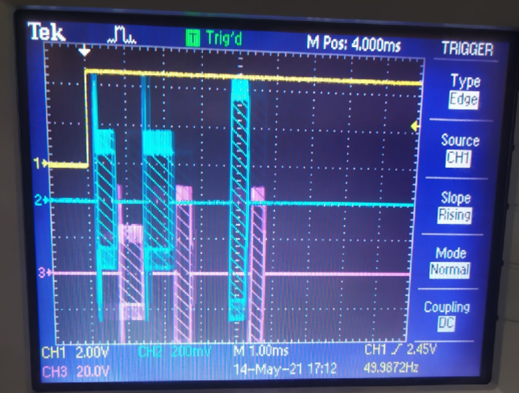

I am using your OMNIBUS II device to generate information signals over MIL-STD-1553 channels in the LabVIEW development environment.
But I faced such a problem that I cannot generate signals on both cores (A and B) at the same time.
The project structure is as follows:
There are two Event Structures to which an external signal comes from one source. After the signal arrives, Timed Sequences are triggered in each Event Strucrure with the same timings. In theory, the waveform of the signals should show that they are triggered at the same time, but in practice it turns out as shown in the figure below:image.png
As you can see from the figure, the signals are generated one after another, and not simultaneously.
Also I tried to create one Event Structure that has two Timed Sequences, but the result is the same.
This is how the Time Sequence looks like for each of the cores (only the value in the red circle changes):
So my question is, could you tell me how to fix this problem?

What are the prorperities set for your subVIs? Are they reentrant? If not, that could be your issue since only one copy will be able to run at a time and it will cause your loops to become synchronized. Also, it is much better if you post the code rather than a picture of it.

Checked out - really didn't expose SubVI's as reentrant. But after I installed it, nothing changed (
I also tried to use separately two subVIs per generation for each of the channels, it also did not help
I am attaching a project. Signal generation is along the path:

Wow, that code is a mess and very difficult to follow. However, I believe that you issue is that your subVI "BC Transmit Dynamic" is not re-entrant so when ever you are calling it in parallel only one instance is allowed to run at a time and therefore you effectively execute them sequentially.
