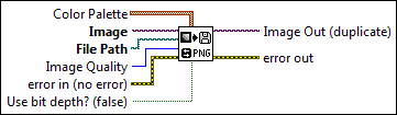

I've found this about the IMAQ WriteFile VI:
IMAQ Write PNG File 2
Writes an image to a file in PNG format.
/images/reference/en-XX/help/370281M-01/c1dnclst.gif
Color Palette is used to apply a color palette to an image. Color Palette is an array of clusters constructed by the user or supplied by the IMAQ GetPalette VI. This palette is composed of 256 elements for each of the three color planes (red, green, and blue). A specific color is the result of applying a value between 0 and 255 to each of the three color planes. If the three planes have identical values, a gray level is obtained (0 specifies black and 255 specifies white). If the image type requires a color palette and it is not supplied, a grayscale color palette is generated and written.

But why don't you use the IMAQ GetPalette VI instead of your switch-case structure?
Selects a display palette. Five predefined palettes are available. To activate a color palette, choose a code for Palette Number and connect the Color Palette output to the input Color Palette of the IMAQ WindDraw VI.

this may be a shock for you, but the IMAQ get palette VI is ONE of the cases in the case structure. But it wont work either way...
I dont understand this one:  If the image type requires a color palette and it is not supplied, a grayscale color palette is generated and written.
As you can see the colour palette is linked to the block, and the palette is definiteliy not only grey^^
I tried the first solution: the decibel.ni ...
Somehow it worked with the testpalette (although it makes no sense to me that i chould use an IMAQ cast image for this problem). So maybe i should look in this direction. Now i have to make a look up table out of the colour palette. If im not able to do it, you will hear again from me^^

Why do you use as image type greyscale? If you want it coloured i would change it to RGB (U32) as you can see in my screenshot.
