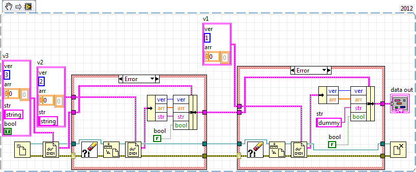

I have a cluster of different data types that I save as binary file and read again at a later time with another VI. I saved the cluster definiton as a typedef so I am certain that I use the same type for reading and writing.
Now I needed to change the cluster in the writing program to include another value. However I still want to be able to use the reading VI to read both old and new datafiles. I also want to have the possibility to change the binary file definition in the future (in the writing VI) and be able to quickly adapt the reading VI to the new definition while maintaining compatibility with older ones.
My plan was to have a typedef of the the cluster for each revision, say v1.ctl, v2.ctl, v3.ctl, ... .
Let's suppose I have a binary input file that has been saved using one of those typedefs but I don't know which one. I would now open that file and try to read its binary content with each of my typedefs as data type and stop once the Read from Binary VI gives no error. Then I would translate that cluster to the current version cluster definition by wiring through existing values and assigning dummy/default values to variables that are not on the binary file.
My idea on how this could work is outlined here with three filetype versions:
For every new filetype version I would need a new case structure although the content of the case structures is almost identical.
Because I save the filetype definition version in my files, I could even simplify and use a separate case structure to update the data and fill in the dummy data:
Now the error case structures are completely identical, only their inputs differ in type. How can I work around that? How can I loop over those different cluster typedefs efficiently?

Since you have a version of the cluster already, just read that numeric byte itself and then use a case structure to go back to before the version and read the entire cluster based on whichever version of the type def you read.

@crossrulz: That's great. I didn't know that you can use the Read from Binary VI to read only part of a binary file, I thought it's all or nothing. Luckily, I have the version number at the beginning of my files, so that should work out in my case. 🙂
What a beautiful solution, never would have thought of that, it works great!
