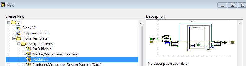

Crtl+I to open vi properties but, you don't really want to do that.  Once you leave a modal vi open and press run while testing some other code you'll understand the pain of working with modal vi's.
A better approach is to set the vi properties programaticly like this:
"Should be" isn't "Is" -Jay

Jeff, you will be happy to know that I used this tactic in full force on a project recently (lots of dialogs in this program).  Not sure how many LabVIEW reboots it has saved me from.  Reuse VIs made it even easier to do.
Now if only "New..." was on a RCM in Project Explorer  (it is under development)
