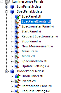

I have a problem with one of my plugins. The plugin itself has a subpanel which loads one of 2 different VIs. The logic and the panel to be displayed is wrapped in a class like this: (SpecPanel and DiodePanel are children of LumPanel)
The panels are started like this:
I made the panel VIs private since only the class should be able to access it. But when I do this, the VIs disappear from the PPL and the main plugin loads broken:
When I make the panels public, the plugin works fine, so I'm leaving them public for now. But what would be the best practice going forward?
