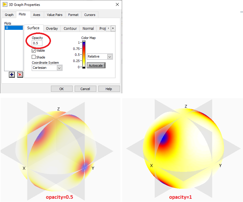

The parametric surface graph has an option for opacity and should solve your problem.
(Here I graph color data on a spherical surface (used here) and if I make it opacity=0.5, you'll see the three opaque planes shining through.)
If I can make a parametric surface sphere, you should be able to make a cylinder. 😄
If I can make a parameteric surface sphere, you should be able to make a cylinder. 😄
But that gives points on a surface of a cylinder (if that is indeed possible.
Not sure, but it seems OP wants point inside a cylinder?
Also, it seems to make the sphere transparent, but I don't see the points on the back of the sphere? Again, if that's what OP wants...
Any example code that shows how to put the opaque triangles on the graphs canvas? I usually give up on those 3D graphs after 10 min.. Perhaps in stead of triangles behind the surface, there's a way to put points inside the surface?

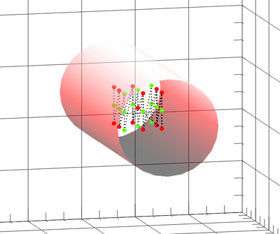

To make it more clear: My idea was to plot a sphere/cube of xyz points which lays inside a cylinder.
I think I will try to plot a parametric surface graph cylinder in the same 3D graph. I will see, if the transparency settings work.
Message 5 of 9
(1,281 Views)
Accepted by topic author Evermax
Update: It worked perfectly!

I enabled with the 3D graphs "Set Plots.vi" two graphs. One for the xyz points with the "3D Curve.vi" and one graph for the cylinder with the "Parametric Surface.vi" (as shown in the snippet below). It's a big plus point for me, that you can combine two or more 3D graphs easy with 3D graphs.
Hint: I swapped the y- and z-coordinates of the cylinder, because I wanted to change the z-direction of the cylinder. If you want to use it regularly, you have to change it back.
