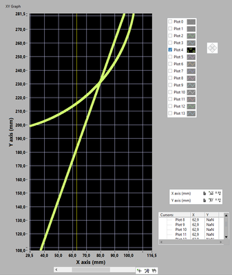

Please help to automatically print the coordinates on the drawn line
Hello, if you look at the vi I made, there are lines from (0,0) to various concentric circles, can you make the coordinates of the points that touch the circle automatically come out?

OK, I had a chance to look at your code, and has has been mentioned, it is extremely convoluted.
  • The terminals of latch action booleans belong inside their respective frames.
  • All your shift registers are equivalent to autoindexing, so simplify!
  • There is an "=0" primitive.
  • Your formula node should be replaced by G code. There are many subexpressions that you calculate multiple times.
  • There are significantly easier ways to calculate circles.
  • Your insert into array are the same as built array(concatenate mode). No need to wire indices.
  • You can build your data as complex datatype. No need for dynamic data and express VIs.
  • To create gaps in graphs, insert a point with NaN.
  • etc.

your original .vi is indeed a bit messy, but when I run your .vi, it creates data in a XY Graph.
the following is focusing on that data in the XY Graph, because I think it would be easier to start over again, than to rework your existing code.
I assume
you want this but the data your .vi creates, looks like this
