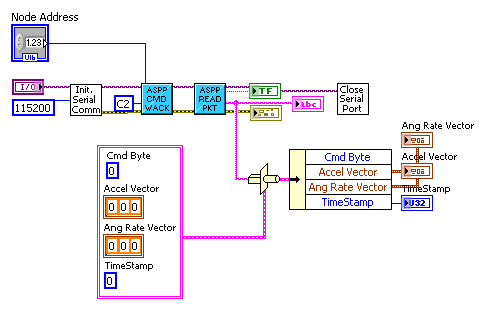

I am using a wireless inertial sensor 3DM-GX2 with a USB Base Station from Microstrain, and I want to read and use data values from it in LabView in real time. But the problem is that I am not able to use the LabView examples or the SDK provided by Microstrain either.
Link for SDK is here:
http://www.microstrain.com/updates/orientation-sdk.zip
I have used the VI called "Read Accel and Ang Rate Serial.vi". I chose the correct COM port for my sensor, that is COM3. When I run, I get an error in the node "VISA Read" (code -1073807339). Attached you can see a snapshot of this VI.
However, I don't know if I have to use this VI because my sensor is a wireless sensor (USB Base Station linked to 3DM-GX2 inertial sensor) and this seems to be a program for reading from a serial sensor.

Hi there, I had the same problems with this wireless sensor and the labview Vi's from the microstrain homepage. Please use the newest ones which are available from the microstrain homepage.http://www.microstrain.com/updates/labview-examples.zip
The problem is in the "Read Accel and Ang Rate Wireless.vi". The node adress is missing. The node address are the last two digits of the
serial number (SN: 4200-1076 - node address=76) and is preset at the factory.
Here is a picture of the changed program.
 I hope that may help you.
