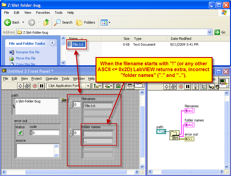

I'm seeing a behavior where LabVIEW's List Folder primitive returns incorrect results for a folder on a mapped network drive, if the folder contains a file whose name starts with any of:
<space> ! # $ % & ( ) + , -
(I suspect it's actually any ASCII character whose value is less than or equal to 0x2D, but some of those are illegal and/or unprintable).
OS: WindowsXP
LV Version: LabVIEW 8.6 and LabVIEW 2009
Steps to Reproduce
(1) Map a network drive to a drive letter (I'm not sure that a mapped drive is necessary, and the network drive in this demonstration is a samba share from a Linux system).
(2) Create a file in a directory on the network share from #1, e.g. "Z:\list-folder-bug\file.txt".
(3) Note that LabVIEW's List Folder function returns correct results when listing the folder you just created.
(4) Rename the file you created in #2 above, changing its name to !file.txt. (The key is that the filename must start with !, or any of the other characters listed above.)
(5) Note that LabVIEW's List Folder function now returns two elements in folder names that don't really exist.
Why This Is Important
This is important because these phantom directories "." and ".." are expanded to "current directory" and "parent directory," which means LabVIEW thinks that the target directory contains a copy of itself and its parent. This produces an infinite recursion when listing directory contents recursively. In particular, the OpenG function List Directory Recursively is affected by this bug and enters an infinite loop when run on the directory shown in #5.

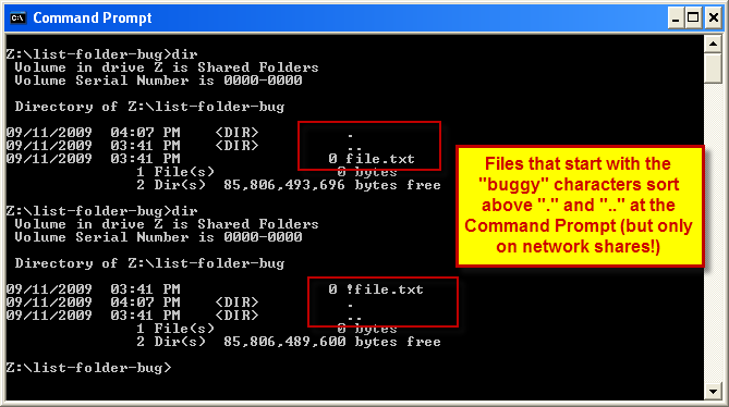

Bonus Information
Note, also that the dir command at the Windows Command Prompt sorts the file list in an odd way for files that begin with the aforementioned characters, but only on network shares.

I think I screwed up the inline images and my post edit time has expired (although they appear OK for me right now), so here they are again.
Correct results with "file.txt" in #3 above:
Incorrect Results with "!file.txt" in #5 above:
 Command Prompt example showing different sort order for "file.txt" & "!file.txt" on a mapped network drive:

That was my feeling as soon as I saw the odd behavior at the Windows Console.
Probably somewhere between Windows being weird and Windows talking to Unix/Linux, the directory results are getting reported back to LabVIEW in an unexpected way.

LabVIEW on Windows seems to use FindFirstFile() and FindNextFile() to implement the List Directory functionality and those do return the . and .. as entries in the directory. Apparently LabVIEW filters them out for good reasons but that filtering gets somehow misguided if the directory is on a network share (possibly only Unix network shares) and contains a file starting with a non alpha-numeric character.
Seems to me like a bad interaction between the Windows API and the underlaying network provider resulting in something the LabVIEW code doesn't account for.
The immediate OpenG fix would be to filter for those directories anyhow, eventhough they are usually not present.

Could be indeed your culprit. In DOS the . folder was the current folder. And the underlaying directory enumeration API in Windows does always return that folder too together with the .. which is the parent folder. LabVIEW does attempt to remove these folders from the enumeration before building the path list to return but it's very possible that some weird interaction with an underlaying network file system driver causes something that older LabVIEW versions were chocking on when trying to remove those superficial directory entries.
As far as I remember the List Directory function assumes that the . and .. are returned by FindFirstFile() and FindNextFile() as the first two entries and that loop aborts as soon as it finds a file that does not match these two file names. After that it goes into the loop that creates the file and folder list and does not filter out those folder entries anymore. So your non-standard filename starting with a non alphanumeriek character is somehow returned by the underlaying file system driver in a different order than what DOS/Windows used to require and the LabVIEW assumption goes wrong. Seems someone in the LabVIEW team did fix this in one of the recent versions.
