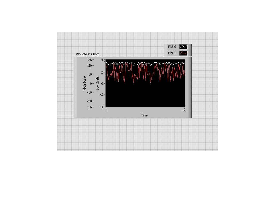

I have a graph with two scales - one for position and one for velocity (which can obviously differ significantly from each other). What I want to be able to do is to have the graph/scales auto-scale - but for the 0 position to remain in the centre of the graph. With the 0 point of the scales in different places it makes the graph very difficult to understand at a quick glance.
If you see the attached screenshot - the two 0 positions are in different places.
Is it possible to have auto-scale, but for the zero to stay in the centre of the graph for both scales?

(As far as I know) you can't do it with Auto-Scale.
Turn off autoscale, then manually set the range to be symmetrical about zero for each scale.
Find the maximum of the absolute value of each plotted array.  Then set the range to + and - this value.  (in the example below, I made it a loose fit by multiplying by 1.1).  Since you have more than one Y-axis scale, you have to loop through to address each one at a time.  First you have to tell it which Y scale you're setting, then, set the values.

Oops, hold on a second.  Now that I look at this, it doesn't quite look right.  I got one scale to go from -23 to +23, and the other to go from -1 to 1... and the zeros line up, just like you wanted....
But the graphs themselves don't look right.  The white line should look flatter than the red line because it's got the same amount of randomness, but is plotted on a larger scale.
Give me a couple of minutes to get that sorted out.

Right-click the plot and associate it with the proper scale. Can also be done with property nodes if you wnat.

Here we have two plots.  Each is the same random signal from 0 to 4.  One of them has been shifted by +20.   The scales line up at zero, and the red one appears wider because it's plotted on a smaller scale.
